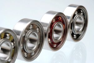

Working together with recognized leaders in advanced coatings and surface treatments has enabled Barden to provide specialized Surface Engineering Technology in support of the most demanding applications for precision bearings. Gary Hughes, Product Engineering Manager at The Barden Corporation, outlines the latest developments.
Engineering surfaces are neither perfectly flat, smooth nor clean. therefore, in terms of rolling bearings, when two surfaces come into contact, only a very small percentage of the apparent surface area is actually supporting the load. This can often result in high contact stresses, which lead to increased friction and wear of the component.
Surface engineering is the design and modification of a surface and substrate in combination to give cost effective performance improvements that would not otherwise be achieved. Surface engineering recognises that the properties and characteristics of a surface are contained within a relatively thin ‘skin’. It is therefore the properties of the surface layers, not the bulk material, which determine and control system performance.
In all types of environments, from aerospace to offshore – where precision bearing systems are challenged by harsh, difficult operating conditions such as marginal lubrication, aggressive media and hostile environments – surface engineering processes can provide improved tribological performance for protection against potential friction and wear problems.
The scope of surface engineering technology encompasses a whole range of coatings and surface treatments that can be applied to engineering surfaces in order to combat friction, prevent corrosion and reduce wear. The resulting benefits are improved performance, lower running costs and longer service intervals. Surface engineering processes generally fall into one of five basic categories:
